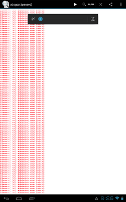

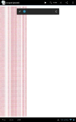

My screen will not rotate and I have tried turning it off and turning it on. & the pinhole
i also tried with it on screen lock. i checked alogcat and there were no error code 26 until i unlocked it and they all popped up!
my accelerometer is also not working so now i cant play racing games or anything :( I dont know what to do :(
$Screenshot_2012-06-12-09-27-00.webpthis takes a lot of my alogcat thing :(
You can try to work around the issue as others do by using the pinhole reset button on the lower right side of the a500, next to the USB port. You also may want to contact Acer as this seems to be bigger issue than I first thought now that more have updated to ICS. Describe the error to them, provide data if they will accept it, and let them know that you have encountered others on this forum with the same problem. I'm starting to see a few new reports of this each day on various forums, and I suspect that this is just the tip of the iceberg -- i.e., I suspect that many people are seeing this beside those who report problems on forums.

The error code 26s occur when the mpu3050 chip in your tablet does not initialize at boot time. None of the motion sensors work at all when this occurs. This is because the "sensors" service cannot register for device interrupts if the MPU init does not succeed. This means that the motion sensors -- e.g., accelerometer, gyro, etc. -- will not work in games or any other software. It's not just your tablet. Others are seeing this also since the ICS update. Some can be cleared using the reset, while others cannot.
