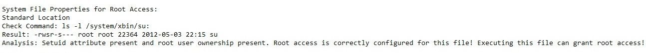

and here was the results from that root checker apk

root checker is incorrect there.
Setuid attribute and root user ownership are present, but permission to execute as a non-root user is not present
Correct permissions for root access should be -rwsr-sr-x root root
Coby put a line that basically disables root in /init.sun4i.rc:
Code:
chmod 6750 /system/xbin/su
Btw I have removed this line in the restore firmware, so it should be fully rooted.
