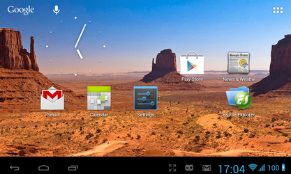

The tablet ui:
On my S7 Slim maked under the guidance of asturel the following:
adb pull /system/build.prop
Edit the build.prop:
smallestScreenWidthDp=0
forcetabletUI=0
to
smallestScreenWidthDp=721
forcetabletUI=1
adb push build.prop /sdcard/ && adb remount rw && adb shell "cat /sdcard/build.prop > /system/build.prop && reboot"
