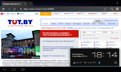

angelsgroup
Jan 12, 2011
20
10
@shin445
I had the same problem just with: "Type password for decryption of storage", after I installed Gapps.
Reinstalling the firmware did not help.
I did a format all partitions through recovery (except sd card and internal memory) and re-install the firmware.
More password is no requested.
Wifi working perfect after my fix.
