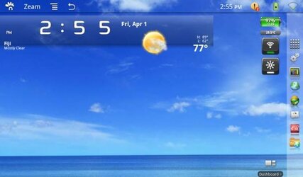

Seem no gingerbread based rom for a tab can take a screen shot. I've tried every app I could get my hands on and no go for 2.3 + NookC. :(
Hey Rico. :) Are you running ADB?...there's a utility in the Android SDK (tools folder) called ddms.bat that allows you to view and capture your device screen from your PC (technically, you don't need ADB for it to work). I'm not sure if it will work under Gingerbread, but it might be worth a try.
Hope all is well!
UPDATE: OK, yep, confirmed. I've got a Gingerbread ROM on my Droid, and ddms.bat takes pretty clean screenshots. Not sure if it'll work for a tab too. My gTAB is Froyo, but I don't think I'll have Gingerbread on it anytime soon. :(
UPDATE 2: I can also get ddms.bat to work on the gTAB with its stock ROM:
-Matt
Ddms does not work with gingerbreadd :(
Sent from my G-tab using Tapatalk
Darn, I'd love to figure this one out. I wonder what's different with my Droid... Maybe it has something to do with how GB is modded?
-Matt
