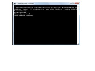

$photo1.webpStep 8 already done. $photo2.webpI followed up but nothing. Pls explaination. Thank you.

I had problems with build 6 . It was always bootlooping (alternate and normal both). I exctracted the exe and messed with flash.cfg and now it is working.
The basic change i did was to increase boot.img partition size.
Maybe it will help others.
Be careful. This may brick your device. I am not responsible.
