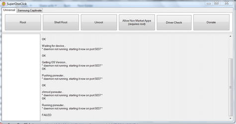

I have tried to root using Z4 root but failed on froyo.
Tried again using superoneclick , got error as the attached capture screen
What would be the cause

Remove all instances of S7 (ie ideos) device in device manager, connect S7 and reinstall drivers downloaded afresh from Huawei site.
Rerun SOC.
Thanks, really appreciated
