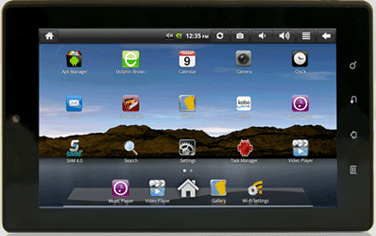

Greetings! I have an Impression i7 tablet that is having the exact same issues mentioned in this thread (have to plug in a USB mouse/keyboard combo to unlock, won't load home screen - Infotm crashing, have to press F1 on keyboard to get to system settings, internal memory error, won't mount an sd card, etc). I am sure that info in this thread can possibly get me a working tablet, but unfortunately it looks like previous Impression i7 owners have given up before even coming to this thread (there are a few posts in the Leader Impression section of people who posted this same issue, were pointed to this thread, then nothing...so I am assuming they gave up).
I have determined that Impression as a company is useless -- they have no firmware updates posted to their website for this model AND they won't help you unless you can provide a purchase receipt (which I no longer have).
From my "About device" screen I have this information:
Model Number: i7
Android version: 2.2-1103_en
Kernel version: 2.6.32.9 Thu Nov 3 22:30:18 CST 2011
Build Number: FRF85B
$Screen Shot 2012-07-03 at 8.51.27 PM.webp$Screen Shot 2012-07-03 at 8.51.48 PM.webp
:: Welcome to Impression ::
As you can see from the pic, this unit has four "soft touch" buttons on the bottom (Program Settings, Home, Back, and Search), a power button on the left, and a Vol - and + on the top.
That is all of the information I can provide on this tablet at the moment. If you can tell me what I need to do to provide more useful information, I will be glad to do so.
Any assistance would be greatly appreciated! Thanks!
