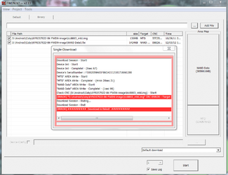

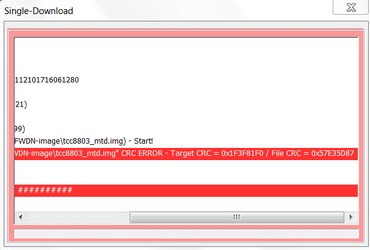

tablet is connected correctly and follow inst from step to step but every time i get CRC error..please help
Can you post a screenshot, please.
Sent from my Transformer TF101 using Tapatalk 2
Here you go, and every time the same.
Your download must be corrupted. Just redownload it
I have tried download 4 times and always is the same result, CRC error, can not be corupt download every time, dont now what to do
I'm sure the error is about corruption within a file. Have you redownloaded the flashing software?
Sent from my HTC Vision using Tapatalk 2
Every thing was downladed more than twice, and every time CRC,
