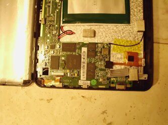

On your 1042 when you took it apart did you notice if wifi antenna could be moved? I was wondering if we moved it would we get better signal and response from the wifi.
Thanks for your gift of Good Luck!
I put it back together - I recall the antenna being right behind the screen about 2 1/2" to 3" from the back button side and top but will have to verify that might even be able to add wire and put it along an edge there seemed to be lots of room on the top edge between the volume and the speaker - will take it apart later tonight and see it it can be moved - I am outside doing flower things with my wife
Do you love your Lenovo or what? My brother had a lot to do with those particular machines and I'd like to give him feedback + or - even though he is with a different company now - in fact he and i are daydreaming about his co doing a tablet series right now which is part of the reason I jumped on the Coby openbox, did not want to mess my wifes up (was supposed to be my last B'day gift but I bet you are familiar with those things too, I do get to touch it onec in a while)
You have been of unusually great assistane and your silence speaks volumes!
I just looked at the blurry photo I took - the WiFi HW is where i thought it was and the antenna is at the lower edge in the area between the screen and the seam - look at the black wire going from wireless hw at the left hand middle of the tablet (in the orientation of the photo) towards the bottom (photos foreground) and ending at the edge od the screen in the photo - I will take it apart again and take a better photo, was being called to the front yard at the time - even if it cannot be moved there is a fairly high likelyhood of the long travel of the wire right on the back of the screen is introducing capacitive effects rendering the antenna less effective - will see what happens if I take the anteaan and wire up off the screen's grounding shield.

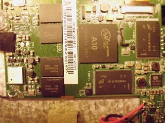

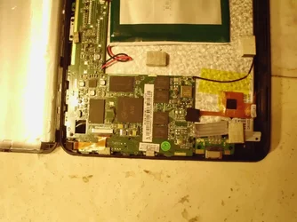

Better photos of inside the Coby Kyros MID1042 8
Got somewhat more range for WiFi by moving the antenna cable from flat on ground shield of screen to above the screeen, 'up' from the front casing so it will be about in the middle of the void between the back and the front. Refer to the 1st photos I posted in this forum to see where the antenna cable was. Also that gets cable way away from battery, battery is D/C for sure but even so might produce unplanned weak electromagnetic fields.
Electricity is really and truly like amgic in many cases, it is one of the few things we know of that moves in the 4th physical dimension (a true dimension, not time, a direction something real can travel in) and despite conventional beliefs we do not fully understand it. Or anything else for that matter.
The actuall antenna is inside a rectangular space, it could be moved within the limits of the cables travel and there are several spaces that would accomodate the antenna, unfortunatly the cable will only allow placing the antenna closer to the board, mostly not a very good idea as the shielding inside is limited and mostly(read exclusively until someone tells us differently, maybe shielding is also different these days) deals with external sources of interference. The actual WiFi chip (marked TOC 9002 in this 1042) is inside a metal cover for shielding.
Shields keep out stuff like TV, FM radio, garage door controls, wireless house telephones and things like that.
A person could add cable for sure but would have to be 100% sure there were no shrots between antenna plus (the inside wire) and antenna minus (the outside woven wire- shield) as well as make 100% sure there was a continous ground shield where the joins (2 are required) are made - in other words the woven wire keeps out interference and you have to find some other woven wire very similar to put around where the inside (the signal) has been joined and covered with spaghetti or shrink tubing. Any transmission cable can lower the signal by capacitive impedance - that happens when 2 metal things (like wire, aluminium foil et. c.) are close but not touching. The WiFi signal will respond only to very tiny capacitive values or little parts of metal very near each other, like small wires very close to each other in one spot. On the other hand there are possible capacitive values that would affect the signal thru harmonics.
People should be able to get all or most chips id's from these photos. If anyone wants specific areas or closer I already have them but the files are between 2.5 and 4 meg so will have to send another way.
As you will notice, there is a number of connection areas for hardware not included in the Coby 1042. There is a hard to decypher hand written revision number on the end (right, we go left to right here mostly) long white label (the number starts with written A printed 1042) and as seen on the small white label the circuit board was made in 2008.
After a closer look in here i believe it is quite possible at least some of the WiFi issues as well as others reported by myself and others may be due to heat. By the time a person felt the casing being warm the chips would be pretty dang hot. IN a couple of days I will take this apart again and put some heat sink plastic stuff (very careful to not short the electrical connections) between the top of the CPU and GPU and the big heat sink/ground shield on the back cover might get a much better acting machine that can be pushed into signaificantly higher performance.
