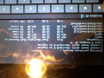

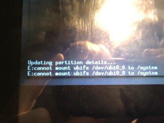

So... I got logs :D Since I am using the 7065 recovery I decided to just use the twrp recovery. cant ruin my tablet more can I? anyways, I'm lazy so i posted pics $DSC_0059.webp$DSC_0057.webp
@ bludot
This thread is about sdcard booting, those pics have nothing to due with sdcard booting. Here we are only focusing on sdcard booting, anything beside sdcard booting just cloggs up the thread and is hard for others to follow.

now I just need to figure out how to restore the main rom. The recovery still has an error with data (which it always did anyways.) heres the log it gives:
E:Bad bootloader arguments
"(null)"
E:unknown volume for path [/udisk/factory_update_param.aml]
E:can't mount /udisk/factory_update_param.aml
when i factory restore:
E:cannot UBI create volume userdata at /dev/ubi0 -22 18446744071780417536
when i wipe media partition:
E:format_volume: mkfs.vfat failed on /dev/block/avnft18p1 (1)
I always had these errors anyways
