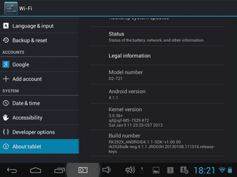

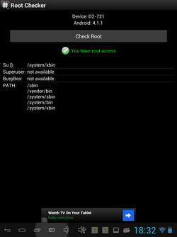

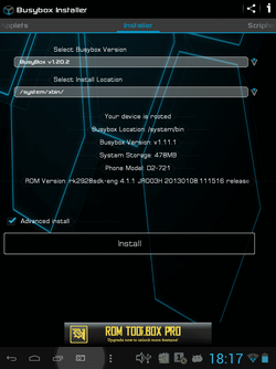

Hey all, I just got a d2 pad from biglots running android 4.1.1, the serialnumber is 201301, so it pretty new, as with everyone it does say rooted
However I cannot get it to show up when i list adb devices
I cannot use anything that says needs root
superuser crashes on startup, and doesnt show notifications when apps try to gain su access
Supersu just starts up, but nothing in it works
$Screenshot_2013-02-19-18-17-19.webp$Screenshot_2013-02-19-18-20-29.webp$Screenshot_2013-02-19-18-21-48.webp
And here are some screenshots that I hope help
Huh! The D2-721 is new- what are its specs? I see it's got Jelly Bean (4.1.1) vs ICS (4.0) on the D2-711 and DII-pad. Does it have 512MB DDR? How much internal storage?
