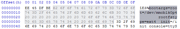

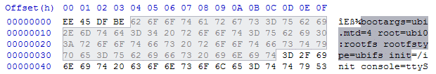

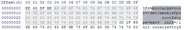

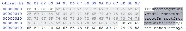

I'll probably release something soon.
For sd rootfs you need to modify the bootargs in u-boot.bin:
-Change "root=ubi0:rootfs" to "root=/dev/mmcblk0p4" for internal sd (or "root=/dev/mmcblk1p4" for extsd), you can overwrite the "ubi.mtd=4" part to make room.
-Change "rootfstype=ubifs" to "rootfstype=ext4"
You'll also have to modify utscript.sh to mount the internal sd instead of the NAND

Funny thing: I just finished modifying utscript.sh to successfully install all files on internal microSD but it wouldn't boot. Then I thought a bit and realized I needed to change u-boot.bin args but I wasn't sure what to use, and I bricked my tablet once doing this so I thought I'd wait for your release... ;)

Well, didn't work here... I am using a new u-boot.bin with a new utscript, it uses a new file called u-boot.arg which has the proper bootarg string (or I thought so), but editing u-boot.arg as you said didn't work. Or I am doing something wrong with mi Hex editor on Mac (0xED). Lemme test with a Win virtual machine, maybe it's something to do with the Big Endian/Little Endian stuff... :confused:
Edit: the edited file looks OK... wth...

Looks like you edited it right.
Can you post your u-boot files and utscript?

Have you tried changing the bootargs in u-boot.bin too?
I believe it is safe (as long as you don't accidentally change anything else).
I think it's the "boardargs" that can cause a hard brick if you mess them up. Of course I could be wrong...

Nope, I didn't. I did flash the modified u-boot.arg and it was like the display driver that was load was for utgm8 instead. I didn't brick tho, I could reflash the correct one later. I have a feeling that either I am doing something wrong or 1024 can't take modified u-boot's... I will wait until warranty is over and I open the table to exchange its internal microSD to try any u-boot mod. ;)
