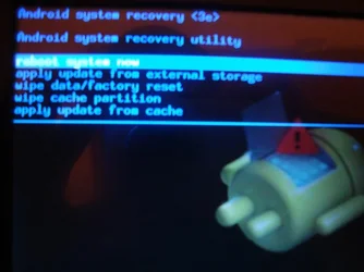

Hello vampirefo. First, excuse my basic English.
The question is I have a tablet Coby Kyros MID7035 (Android ICS 4.0.3, Kernel 3.0.8), which I had rooted. But, I needed to install CWM recovery, and then use your file "7033_fix". Now my tablet is always in "Android system recovery utility", and although I use "reboot system now", boot always returns to the same place ("Android system recovery utility"). ¿Is this the famous "brick"?
Anyway, I need your help to solve this problem, please, if you do not mind. Thanks friend. Regards from Argentina.
Edit: maybe this will help?: MID7035-4-dump
