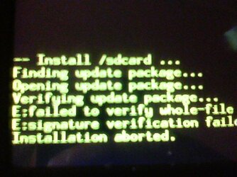

Update:
Have tried a few things (using Xubuntu 13.10)
I downloaded the .rar file above, then changed the folder to a zip.
Renamed it to update.zip and tried it in the 7033. It behaved differently..in that instead of saying the signatures weren't right etc, the 7033 paused for about 10 seconds and then flashed up a big Android logo for a few seconds, with a crystal thing coming out of its middle (lol, you'll know what I mean vampirefo). But then back to the usual options of the Recovery section.
Then I thought 'well it wont boot if the SDcard isnt bootable'.
Downloaded and used Brasero, to make a .iso file from the .rar unzipped file.
Put that on the SDcard using UNetbootin.
Tried again and it didn't boot.
So, tried going into Recovery and selecting to update from the card again. Surprisingly, the original files were still on it, so I ran update.zip again and this time the 7033 flashed the screen on and off a few times over about 30 seconds, then rebooted itself.
Now, it's just sat on the Coby logo.
No idea what it's done if anything, but it IS doing something differently, instead of completely refusing to play ball with whatever goes onto the SDcard.
I wonder if this is useful ?
I tried the fake_7036_recovery.zip just to try it and it began to verify the package !
The 'loading' type bar moved across as though looking seriously at it, before doing the usual abort.
Am going to have a look at whatever differences there may be to whatever has been downloaded for the 7033. Stuff that no doubt is already a road well travelled, but not by me and it's interesting :)
