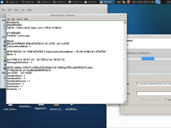

Having found that Abiword and other Linux text editors display garbage, I opened the .ini with Windows Notepad. But it still looks the same - screen capture below.
Within, it says PackFile=vortex.pak and that will presumably be replaced with 7033.pak ?
No idea why the .ini file displays corrupted.

I use gedit, also it's in another language.
Here is English translation

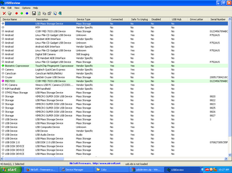

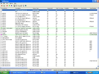

Update-
I grabbed USBdeview from here: View any installed/connected USB device on your system
It shows all connected devices as well as what has ever been connected.
The MID7033 shows up as connected.

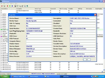

And here are the properties of the tablet.
