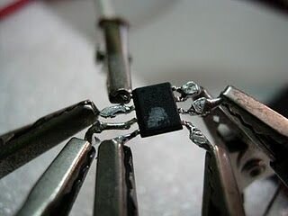

Searching for reference to JTAG and "SPI Flash Programming"‏ specific to these tablets. Different chip but equivalent method. Re-programing SPI Serial FLASH on CPU Daughtercard (De-bricking) - SlateDroid.com - Page 6
Absolutely no relevant information in this video other than -
  • The amount of effort needed to unbrick a device
  • If you find a solution, it can become a business
  • Music and fast forward requiring little attention span
Here's a place to start - Unbricking Gome/Fake FlyTouch Android tablet. Interesting photo.
