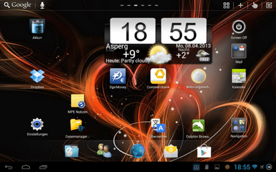

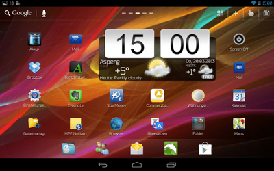

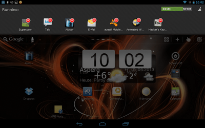

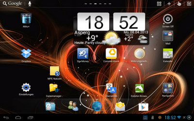

Another Question: On ICS the Stat-Line is located on the left Side of the Bottom of the Screen. When I has installed JB, the Line (with Home, Back & App Soft-Button) is about 2-4 times on the left Side. On the right Buttom-Side is the Information about Mails, Screenshots, SD-Card and the Clock, Wireless and Batt-Symbol. After a while, I don´t know why, the Home-Button´s changed in the middle of the Screen and the right-Button-Side changed to a small-Info-Line on the Top.
I have read about the Jelly Bean 4.1.1, that google has implemented this in the middle, but why it would be not changed direct after the Installation?

As for other issue, it looks like in the 1st two pictures you posted it's in phone-mode and the last 3 it's in tablet mode. Your launcher looks quite a bit different than the Lenovo one in the A2109. I'm not really sure what to tell you.

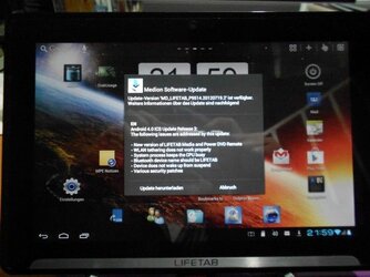

Hi vampirefo.,
there where a misstake. Medion has 3 update in 3 Weeks. I post the wrong link. Sorry, sorry.
enclosed you will found the right link (The right number is dated from 20120719 - I think, no newer Update are coming).
http://cdce.ams002.internap.com/tapntap/medion/Lifetab_p9514.20120719.2-ICS-signed-ota-update.zip

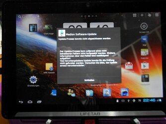

BTW: I have tested the ROM from you. while flashing appears the message Random offset: 0x131. I flashed 2x more with the same 0x9f and 0x3a.
After flashing the tab would be hang on Medion sign. I been waiting about 6 Minutes then I used the Reset-Button. (This Tab has one)
Then the Tab is booting. After boot I received the messages below. The last Pic´s are Screenshots from my Tab.The left is after flashing the ROM from ysterday - the right is my Tab after Restoring backup!
After this message i do a full CWM-restore.
It is possible - like replace a app - to put the CWM - Image 6.0.2.8 in the ROM? You can do that? It is not neccessary - more a question!
... and add Quick Boot to the ROM´s App. When the Tab is off, you can not go easy to recovery. This App do this very well.

Hi vampirefo.,
thanks a lot for the ROM. It work´s.
A last question:
The ROM would be flashable over Android Recovery 3e?
Must the ROM Name renamed to update.zip?
I will changed the bootanimation to lenovo.
It work´s - I have been tested.
Only replaced the bootanimation.zip and repack with winrar to a new zip-File?
In the evening, I posted the Thread here in german forum. (with your Don.-Link)
Greetings
Louis :rolleyes:
