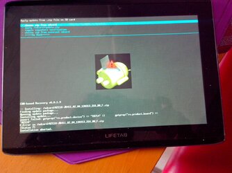

Hi,
I will flash the new JB Update feom Medion / Lenovo A2109A aka A2110A.
Here the link:
http://tapntap.http.internapcdn.net/tapntap/medion/A2110-JB411_02_00_130313_316_WW_F.zip
I take a look inside the zip-File. I´m sure, this is the right stock.zip!!
I do this over CWM. Enclosed you see the error.
I think, the Stock.zip must be changed to CWM.zip!! Then I can flash it with CWM.
I don´t know, how to do this.
Any Idea???
Greetings Louis777
Flash Stock.zip over CWM on Lenovo A2109 aka Medion Lenovo S9714
open the zip edit update script remove "assert(getprop("ro.product.device") == "S9714" || getprop("ro.product.board") == "A2110");" then rezip and flash.
seeing you have cw recovery, open the zip add root remove recovery files, and remove any apps you don't want then rezip and flash the zip.
