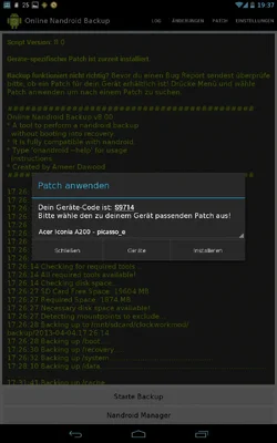

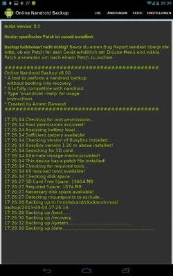

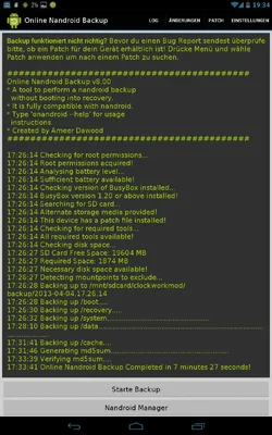

Hi vampirefo.,
you remember, the LifeTab Lenovo S9714 aka IdeaTab A2109A. You has been changed succesfully the ROM.
The Tab work´s after a couple of days very well.
In the between time, I has received a changed Hardware-Script to LifeTab S9714 from the OnlineNandroid Backup-App for CWM.
It works too - you know, the Backup works on OS - you need not to boot in CWM-Recovery.
My question is, the CWM-Recover-image 6.0.1.9_d is for IdeaTab A2109A. It works but is inside the Image the Adresses - mount Points etc. right now for the S9714?
I send Hard- and Software Information about the Tab to the Developer from the Script, to Ameer Dawood. After this it has been changed the Hardware Script to "Medion_S9714 - kay".
First Backup from CWM failed in one item - Recovery was not backed up. In the between time it works both - CWM-Backup and Onandroid Backup. I don´t not why?
I found a website from Koushik Dutta, one of the Depeloper from Clockworkmode, where you can build CMW-Recovery.
Recovery Builder
After the Backup I load on the builder-site the recovery-image from Onlinenandroid Backup. The Recovery-Image has been succesfully generated. After the comparison with
the two recovery´s the A2109A_d_JB and the new one - the diff. is obout 1,5MB. ---> Correct - I used 2 diff. Filemanager, only 4 Byte diff.
What do you mean, can you take a look on the site and the files? Can I flash the new one with adb ? ( Any Reason against? )
Here is the link from the generated Recovery-Image - Number:9124d257d15f5281f26a2c1bd637dbd3
( you can download the generated CWM-Recovery-Image there )
recovery 9124d257d15f5281f26a2c1bd637dbd3 [Jenkins]
I think, when this recovery is o.k. - only changed it´s name to Medion_S9714_A2110 - and this is a original CWM-Recovery-Image?
Let hear from you, what you think about this.
Thank´s a lot.
Greetings
Louis777
P.s.: I hope you understand all was I have written.
Enclosed some Screenshots from OnlineNandroid Backup:
$Screenshot_2013-04-04-19-30-44.webp$Screenshot_2013-04-04-19-34-28.webp$Screenshot_2013-04-04-19-37-34.webp$Screenshot_2013-04-04-19-38-11.webp$Screenshot_2013-04-04-19-38-28.webp
