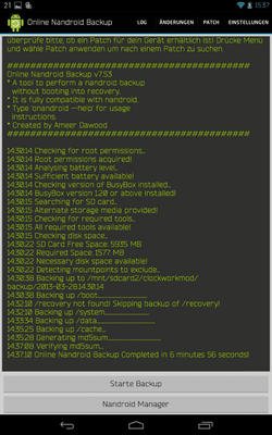

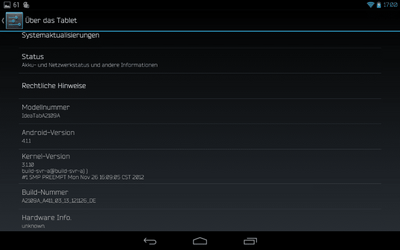

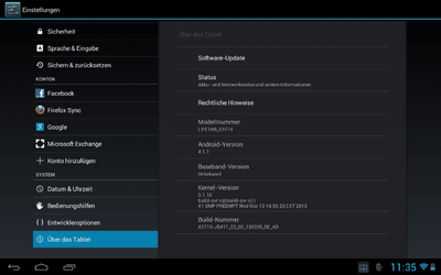

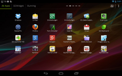

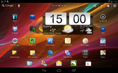

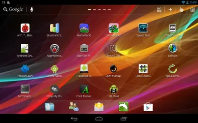

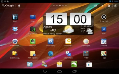

Hi,
I´m a new member in this forum. May be you can help me.
I used a original Medion Lenovo LifeTab named S9714. The second Item is A2110A. The device has a MicroSD-Card and a SIM-Card-Slot build in.
I rooted the the devce - and unlocked the bootloader. Then I flashed the Original ROM "A2109A_A411_03_13_121126_WW".
I flashed the "CWM A2109_CWMrecovery-6.0.1.9d_JB.img" and the "Superuser-3.1.3-arm-signed.zip"
After the first boot i renamed the "recovery-from-boot.p" to .org. Then again the "CWM A2109_CWMrecovery-6.0.1.9d_JB.img".
I hope the listing of doing is right. Well, the device is rooted and works very well.
After one or two days, i remember from the SIM-Slot. Nothing wood be displayed. No IMEI-Number and Fon-Item and so on.
Is is possible, to restore the IMEI Number. On the Backside of the Tablet stay the IMEI- and the Serial-Number.
All Apps and the onandroid backup works very well !! (but i do this in CWM recovery with backup. In onandroid recovery wasnt backed up)
Enclosed you see same Screenshots from my new device!
Greetings
Louis777

@Louis777
I do not think A2109A_A411_03_13_121126_WW has support for 3G.
When I ran it it also ignored SIM card.
Thanks
