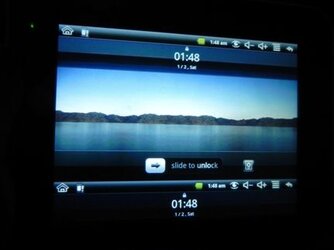

Hi, i installed this fantastic rom, the only one installed without problem in my mid tablet.
the only problem is it that the screen is not 100% occupied and is divided in two part, not using all the resolution available, and also i cannot calibrate the touchscreen...
I wonder if someone can help me to manage that..
Thank you very much in advance

No dear Tipstir, i cannot use it since the screen is divided in two parts and does not fully occupy the desktop, and cannot calibrate the touchscreen.
I attach a picture, is not made with your ROM but the original one, but the result is same

Any help very much appreciate
Video issue cause by your hardware and the ROM are not compatible. Are you saying it was like that prior to you using the ROM. Do you have flytouch / epad?
