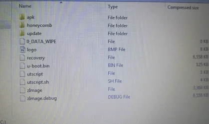

I got the same problem with this guy, just that unfortunately , i can't seem to boot using the external SD card , i tried 6-7 cards and it's still the same line" Can not find any update image" . Can someone help me ? Or are there some ways to connect to the internal SD card. Thank you.
are you uncompressing(unzipping) files to sd card. Make sure your card is formatted FAT32.Very important your files should be at the root of your sd card not inside of a folder. I use a 1GB card for flashing maybe your 6GB card is the problem
sd card should look like this before flashing
