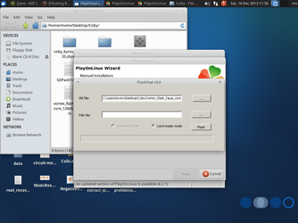

Update -
I copied the dll files from your DepositFiles link to the 'system' folder of Wine (1.4)
Downloaded the flash tool and installed/ran it with PlayOnLinux.
Looks promising to me from the screen grab !
Could it be a route forward ?
$Screenshot - 12142013 - 11:56:40 AM.webp
It's asking for an .ini file and then a .pak file
The .ini would appear to be the 512MB one, of 2 choices.
The .pak is perhaps the one you would create for the 7033 ?
