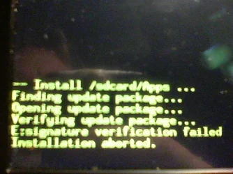

My MID7033 is still bricked...so I was delighted to see this thread !
Hoping to help, being as I have a 7033 here.
To recap, it's not even rooted this one, got it on Ebay some while back and had only installed a couple of games. I'm new to Android. Nothing else was done and then one day it sat bootlooping on the Coby logo, right out of the blue. And has ever since.
It will go into the recovery type of section though.
I downloaded Todd's full 7033 dump from Page 2 of the thread.
Downloaded Vampire's edited recovery.img, from Page 6 and replaced the original with that one.
Renamed the dump to update.zip
I've tried to run the both of them, unedited and edited, but get the result shown below in the pic.
Sorry for the blurry fuzziness, the camera doesn't do close up work.
Looks like it's just failing to verify.
So, am really eager to try the method shown in your post above Vampire (if and when you see this).
Thanks :)
I'll wait around, no problems there, but am interested in what should/may/could happen with a file of wrong signatures ?
You may have a great piece of the puzzle if they are right. As I say, I don't know that much about bricking, except that it happened.

@ Slider2732
We aren't yet to the point where we can fix a nonrooted bootlooped 7033. The bootloop problem is real on these tablets, caused by the nand, getting corrupt, happens to me as well. I have only had this tablet a few days, but have made progress as well as making tools to correctly format nand, I have had to modify the CWM recovery to not install backups, and formatting needs to be done via command line using my tools, as recovery formatting partitions can cause bootloop.
The bootloop is caused when the default recovery formats any partition, So what my recovery will do is provide adb support, as well as flashing roms. if nand partitions becomes corrupt, then reboot into CWM recovery use adb to correctly format and repair it.
This is going to take some time, for me to write instructions so that most people can follow, not everyone will get it, I will load the recovery with scripts, so people just type the script name and it executes the commands, so as not to confuse people.
