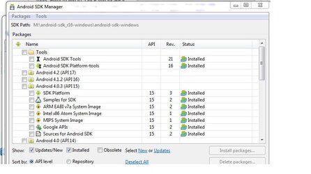

hi I have a new coby 8042..I decided to root this even if it still 2 days old..coz i cant download from get jar..i dont know why..I used windows sdk..when i type command "adb devices" my device is not detected. .i tried to install the android 4.0.3 API15..in the SDK Manager..still it wont detect the device. $and.webp
If I'm not mistaken, the drivers for ADB are not automatically installed when the SDK is. So, you need to connect your tablet to your PC, then open up Device Manager. If you see something like "Android 1.0" then the drivers aren't installed.
yes the drivers are not installed..I see "android" in device manager its question mark..what's the next option for me? thanks mods
