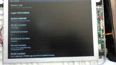

I have Apad imx515 with 2 speakers and no screws. Nothing worked so I just opened it and took out the sdcard and re-wrote the image I had backed up of the Android 2.2. Now It is able to boot.
The image is not clear but Model number is imx51_bbg. Is this version not supported? If not then it is my mistake.

Its does look like a normal 8" IMX515 tablet.
What is the last message from the romkit after you have step 7 is completed?
